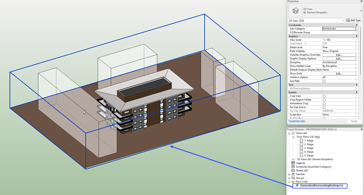

Elements from Revit links are now included in Daylight Ratio and Factor calculations.
You can now Link surrounding buildings and toposurfaces to your host project as Revit links. Elements will be considered when calculating Daylight Ratio correction factors and when calculating Daylight Factor values.
