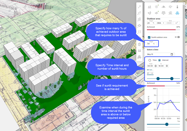

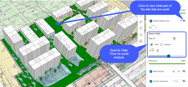

Sunlit analyze
Visualize sunlit areas for specific dates and times, number of hours during a set period or percentage of sunlit area.
The analyzed results use Forma Sun Hours calculation; if there is no valid sun hours calculation performed for the day you specified, a "run analyze" button is displayed.
Specify a date and time for the sunlit analyze, and visualize what part of the Achieved Outdoor Area that is sunlit by clicking on the "eye-toggle".
Or specify a date interval and number of hours that should be sunlit and on how large the Achieved Outdoor Area that needs to be sunlit to examine if the building site is below or above the target.

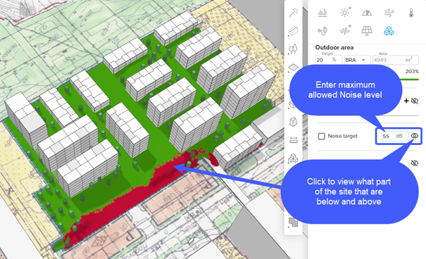

Road Noise analyze
Adresses the noise levels on the building site to remove areas that are above specified noise levels.
 The analyzed results use Forma Road Noise calculation; if there is no valid road noise calculation for the active proposal, you are asked to run the analyze.
Note. You must add roads and enter traffic information in Forma to do the Road Noise Analyze.

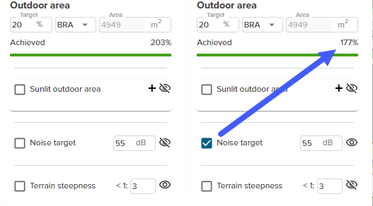

Enter the maximum allowed noise level in decibel (dB), and the area of the building site will be analyzed. Use the "toggle-eye" to visualize what part of the site is below and above the entered noice level.
In the image above, all parts of the building site marked with red color is defined as higher or equal to 55dB. The green parts define the areas below 55dB, and hence accepted as outdoor area.
When you enable the noise target toggle button, you include the Road Noise Analyze in the Achieved Outdoor Area Analyxe, and the achieve bar in the top of the dialog is updated; only the defined green areas of the building site is included.

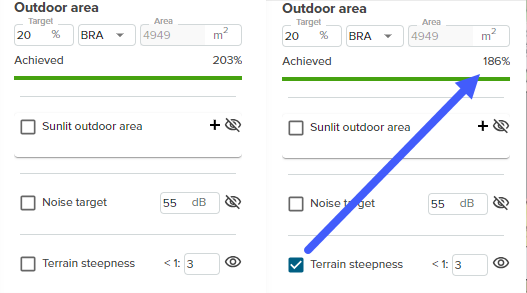

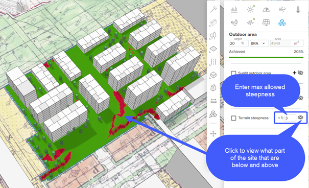

Terrain Steepness analyze
Find the steepness of the terrain with a terrain ratio; all parts of the building site with steepness above entered ratio are removed from the available outdoor area.
Use the "toggle-eye" to visualize what part of the building site that is within the target values.
In the image above, all parts of the building site defined with red color have steepness higher or equal to 1:3. The green areas are below 1:3.
When you enable the Terrain Steepness toggle-button, you include the terrain Steepness analyze in the Achieved Outdoor Area analyze, and the bar in the dialog is updated; only the defined green areas is included.
